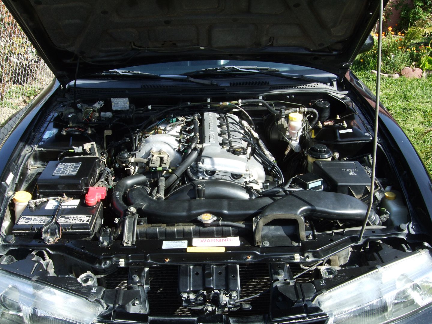

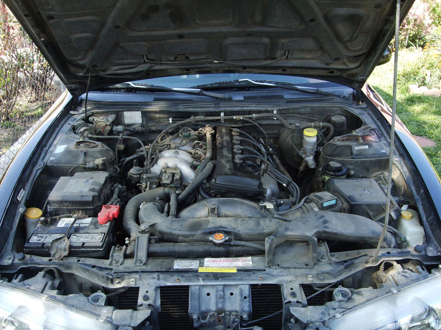

    Here's a pretty good before/after.
    Didn't take all too long. Degreaser, brush and hose with adjustable nozzle.

    Quote Originally Posted by CrimsonRockett View Post
    Pressure washer would make things a lot easier (which reminds me, I should really go buy one).
    Damn pressure washed the black right off the valve cover...that's what i'd call clean.

    Don't know what he said before the edit, but it's definitely the same car/engine bay.
    Nothing was modified/painted at all. It was just washed.
    Same valve cover. Same everything.
    That car was purchased from the original owner(woman). She didn't bother having the valve cover gasket replaced. So, that's a good 10+ years of oil slowly leaking out.
