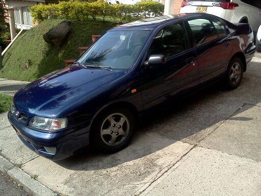

My car is a Nissan Primera 1998.
The car idles normal, sometimes just a little bit lower than 700rpm but nothing extreme. The problem is when I start to drive it normally, the car starts to do like some pauses in the rpm range (hesitations), the feeling is like when you turn on and then turn off your A/C, but it does not impede to go through the rpm range until reach the rev limiter. The pause or hesitation doesn't appear at full throttle (WOT)
I can rev the engine freely in neutral, and there isn't any hesitation. its when i drive the car that the weird hesitation appear.
I already change the knock sensor
let me know your opinions about it..

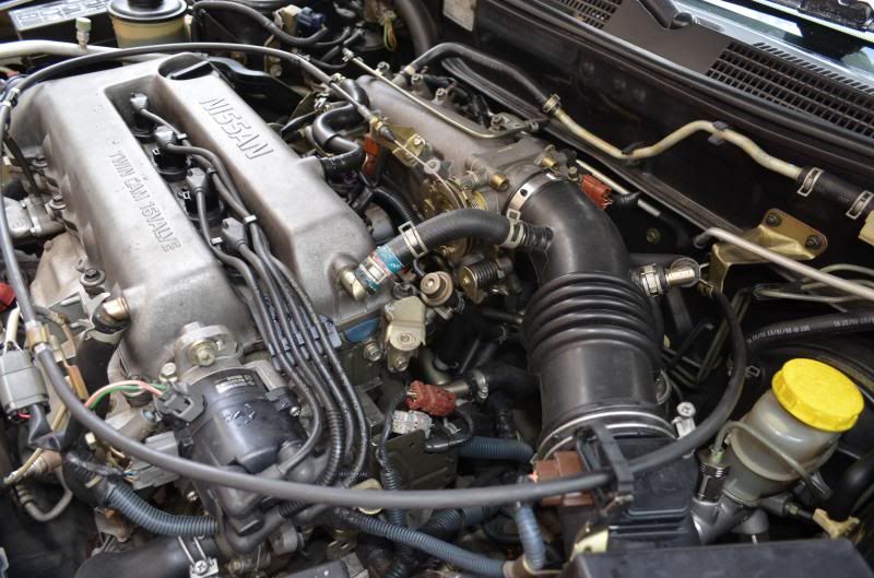

Does this look like your car?
http://www.npoc.co.uk/forum/nissan-primera-p11-144-possible-faulty-maf-sensor_topic26589.html
My car has a Sr20de RR. Is a P11
i have a nissan OEM MAF. I already clean it but nothing change...
