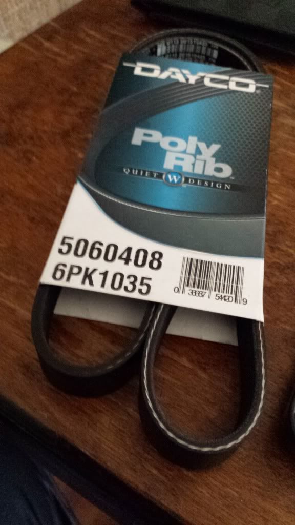

nope no overheating or anything. It drives perfect and has lights. Its just the noise that bugs me. I decided to go buy new belt and will be put it on sometime next week when I have a chance. I think its prob the belt since the noise change when accelerating and increase acc. load.
