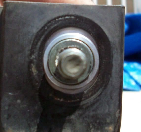

Pictures of these on a B13/B14 which for all intended purposes serves the same exact function:
552 Posts
Do you have a pic of them installed. This sounds like a nice item.
552 Posts
those look awesom

seriously bro, im digging your work, so please take this as constructive criticism...
In this case the delrin is completely pointless, just make it a solid aluminum mount.
Lets also be clear, this isn't going to do anything for you if your motor mounts are shot.
I've ran full Delrin and the Delrin holds up just fine so even if I made them in full delrin i'd have no worries about them. I also ran with full aluminum to and trust me it does transfer more vibration into the cabin vs aluminum bottom delrin top and this is the reason they are being made like such. So I wouldn't say pointless because there is a difference and I know that difference because I experienced it first hand. But no critiscism taken, there is a reason I made them this way.
You are right though (without saying) about they wont make a damn of difference if your rolling around on busted engine and transmission mounts, but that holds true for all other bushings in your car, and the opposite is just as true for having solid engine mounts but busted crossmember mounts.
So lets be clear there is no one magic part to fix all things sloppy and loose when it comes to tightening up your cars suspension, engine, subframes etc etc
But i'd say of all the parts I've made for my P11 its pretty much damn near there, I'd say all I got left to do is subframe bushings.
Once you start tightening up suspension and mounting components your weakkest links always show there weakness and its up to you to upgrade replace those components until everything is done.

So I wouldn't say pointless because there is a difference and I know that difference because I experienced it first hand..
Good to hear you tried the different mounts out.
One other question, are you going to stock replacements for your other delrin parts, because they will fail over time. Namely the lower LCA bushing?
Yes, they are the same bushing.
You have already asked that question and I answered it and here is teh answer below again:
http://www.g20.net/forum/showpost.php?p=1456535&postcount=32
whats your replacement policy if the delrin fails?
By the way they have been good to me already for over a year now on my daily driver.
If they fail they buyer can ship me the LCA Aluminum housing with delrin bushing back to me and for $40 + shipping I can make a new bushing and press it back in.
The delrin is press fitted into the aluminum housing, its not meant to rotate in the aluminum housing, the LCA is meant to rotate in the Delrin bushings. This is a reason its important to follow the directions I been laying out here about the sanding of the LCA with id say 600 grit would be fine until you achieve a nice snug fit, but in no way should it ever be a press fit of the LCA into these housings, keep sanding and checking periodically until you get a nice snug fit. Delrin is way stiffer than polyurethane so each bushing is made slightly undersize so as not to be a loose fit and to take into account slight tolerance differences form vehicle to vehicle.
I been using my daily P11 with these bushings for about 10 months now with no issues as of yet and I dont expect to have any but i'll be checking them out in a few days here when I install some UCA's.
