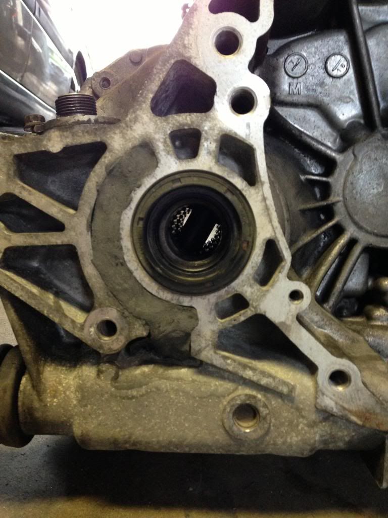

Upon receiving my junkyard trans I got some Quicksteel and filled in the large open space that a lot of guys were saying was a problem area. A little side note, the original cable speed sensor fit perfectly in the new tranny.

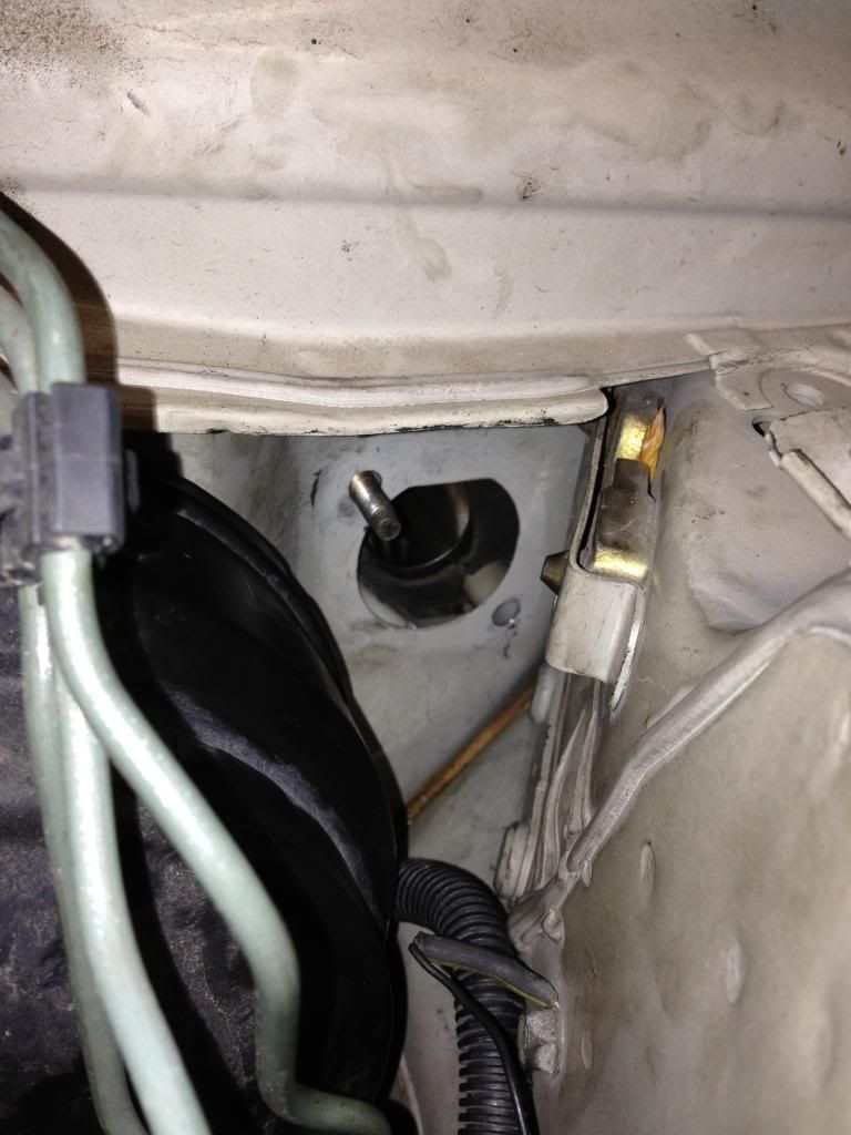

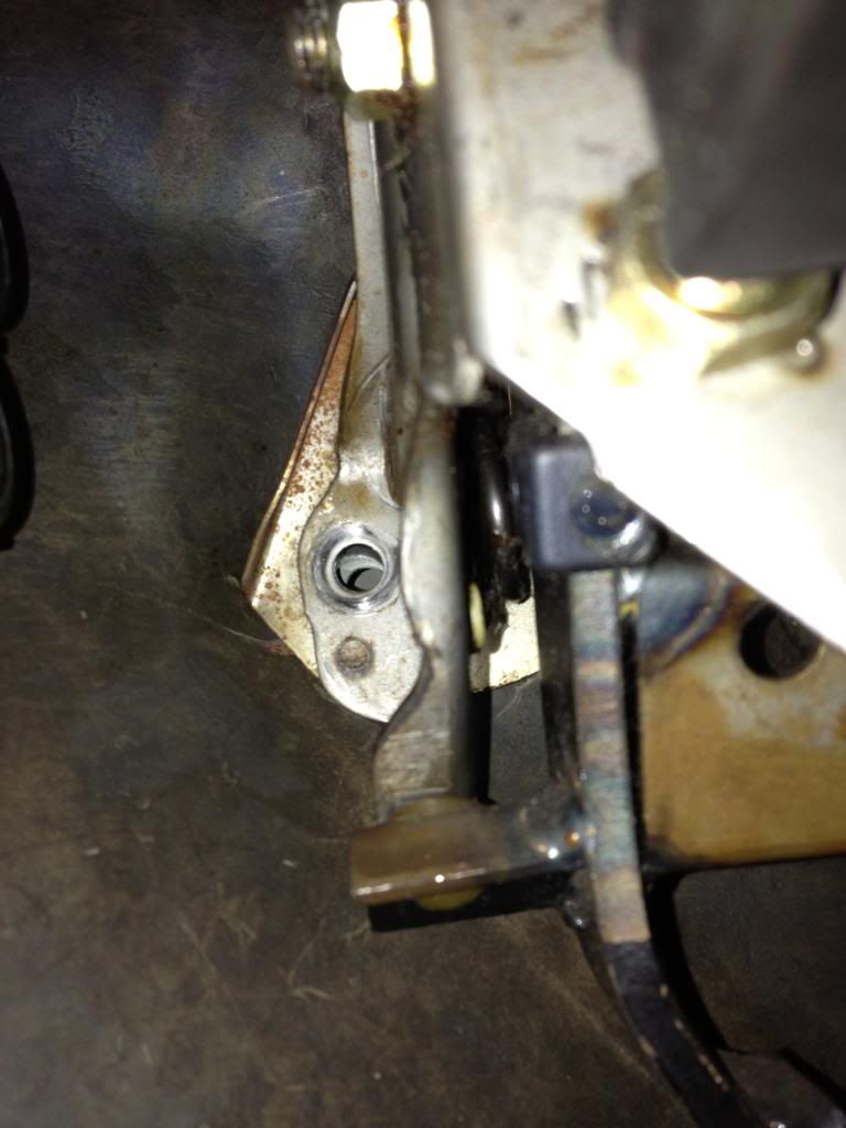

Hole in the firewall where the clutch cable previously ran and where the new clutch master shall sit.

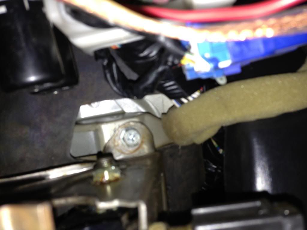

Three bolts hold the clutch pedal assembly in, two through the firewall to a bracket, the other goes up towards gauge cluster and such, this is one of the two for the firewall
Sorry kind of blurry, but this is the third bolt holding the pedal in.

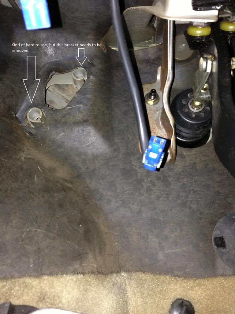

Some guys when doing the 6spd swap said to leave this little bracket on the inside of the firewall intact. I couldn't do it, I had to remove it. I simply could not get enough pedal travel with it still connected.

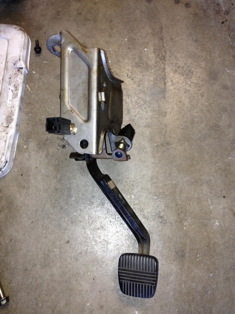

Junkyard special pedal assembly, there is also 3 mounting holes for this one. the two in the firewall line up great, the third one on the top not so much. I heard you "should make a bracket", "no you don't need it" me personally, I didn't make one and its holding very well. Stage 5 Clutch Masters kit and i have zero issues with the pedal moving.

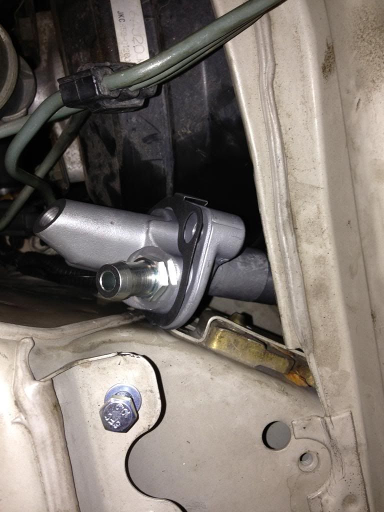

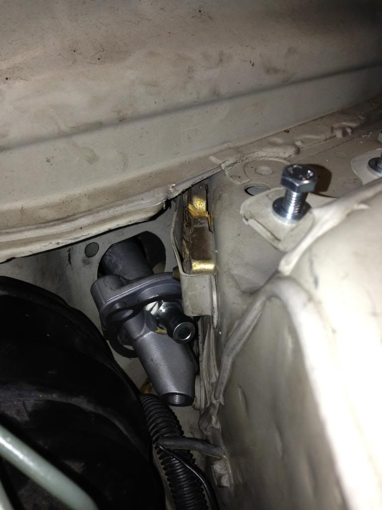

New clutch master cylinder from the dealer
tried and tried and tried to fanangle it into place, just wasn't going to happen.
Finally with an extra pair of hands and after loosening the brake booster (not completely removing it) got it to slide in

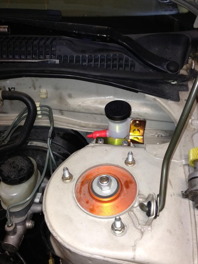

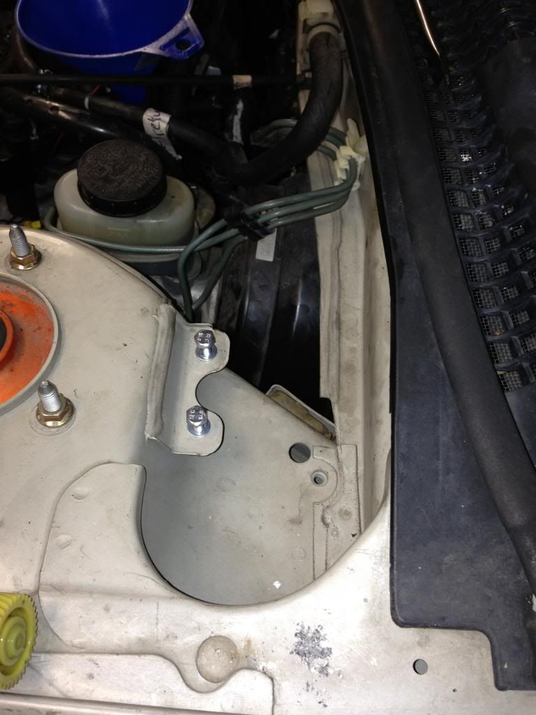

Little bracket on the top of the strut tower looks almost like it was put there on purpose.
Perhaps it was... The 99 reservoir with included bracket fits perfectly and with the factory hose from the P11, there are no pinching or binding issues.

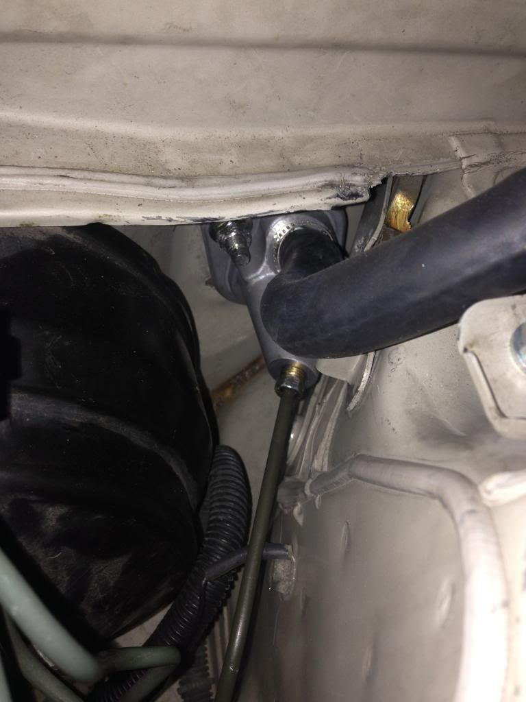

Getting the two bolts that run through the firewall to snug up was an SOB. But, with some patience and jerry-rigging, got them all tightened up, normal pedal location, same as the original.
No clearance issues with the strut tower, EXTREMELY tight fit, but it works.

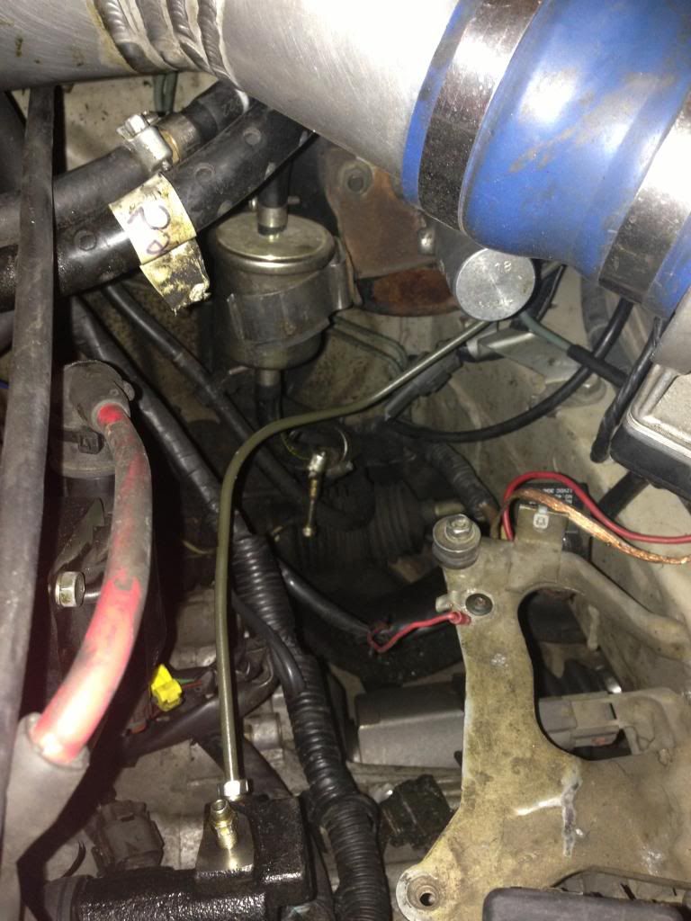

Brake line I used to make the line for the slave

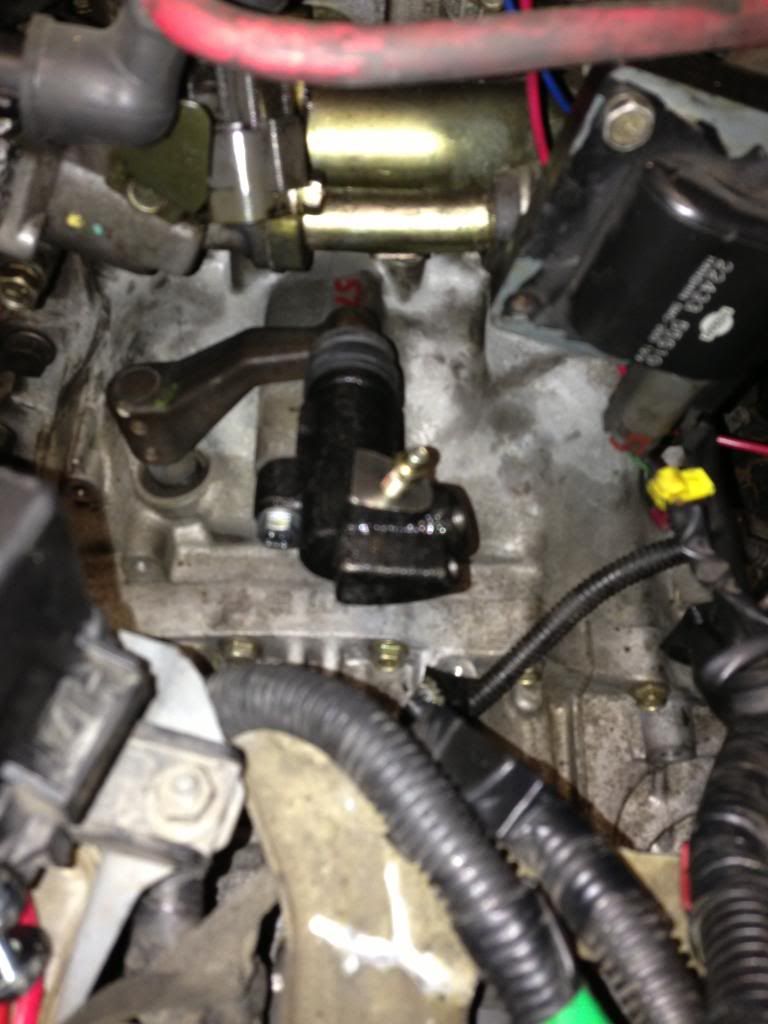

Slave installed

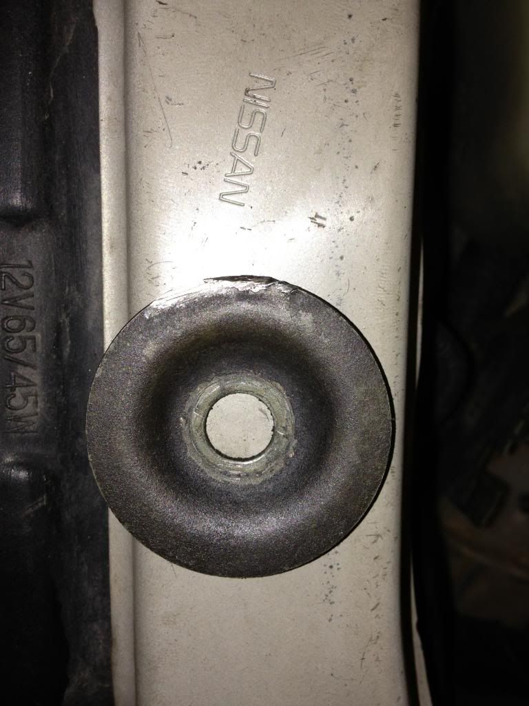

The only real issue i had was this little thing. Its the washer that holds the shift stabilizer onto the mount. When I would engage 1st, 2nd, 3rd, or 4th I would get real bad binding, cause by the actual gear selector rubbing on this washer, you can see a bit of the metal exposed. I guess Nissan moved the location just slightly for the B15 and thusly caused the issue. A simple grind on both sides to shrink its width and it fits like butter.
