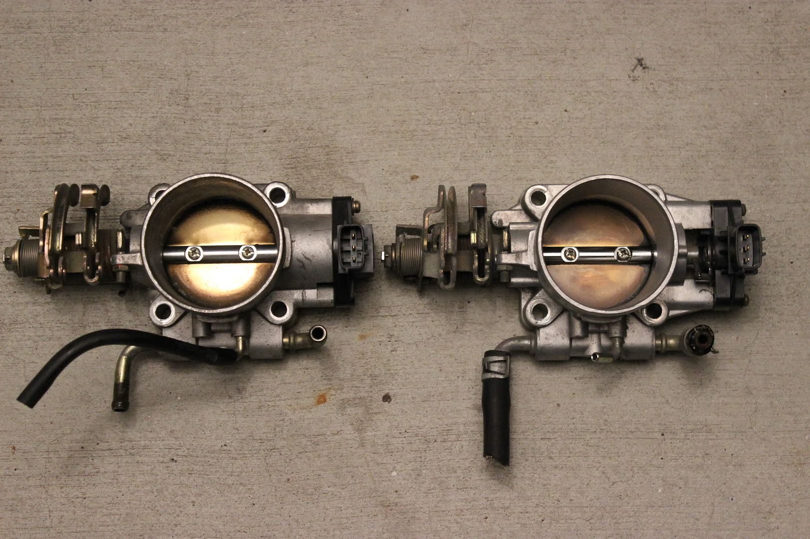

Picked up the TPS and throttle body, will I need a manual TPS or will the automatic work as needed?
Pictures below:
Now, if I can use the auto sensor, will I need to do anything funky to the wiring or can i just solder it to a new plug to its appropriate pinout?
If your 5 speed you need a manual TPS that one in the picture will not work. You don't have to do anything extra just plug it in once you get the 5 speed TPS.

Well you can get that 5 speed TPS from any 5 speed B13/B14 up to early 97 and any P10 lowport or highport.
