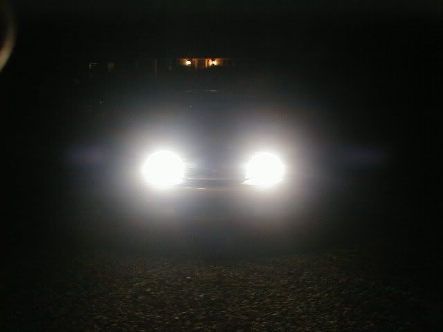

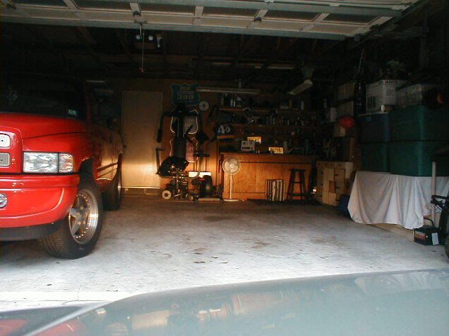

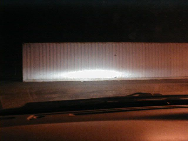

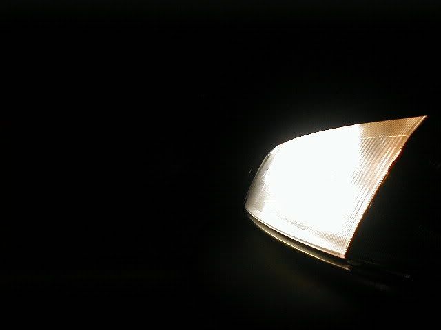

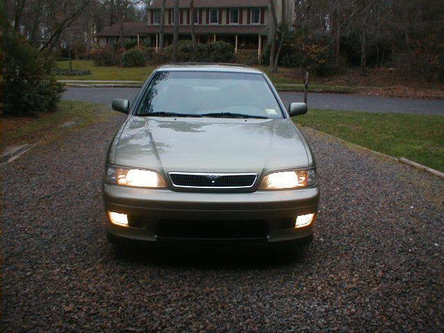

well i finnaly did it.. maxima ballasts, 4300k oem D2R bulbs.. homemade wiring harness and casper sheilds
THE BEFORE
AND THE AFTER
with flash on
flash off
really close to a metal thing
further back
even further.
and yes.. my lenses are FOGGY AS ALL HELL!! once i polish them i hope to get a brigher output

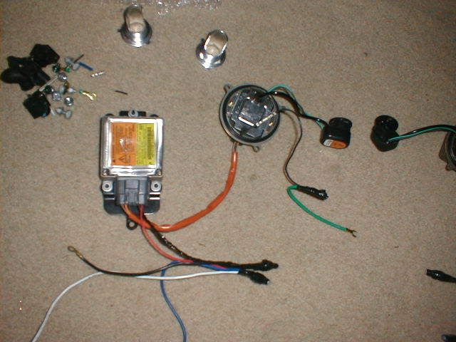

^^ yea the sheilds work amazing.. theres only a shread of glare light up above.. but i played it safe and went with D2R(sheilded bulbs) and the casper sheild too.. if i were to swap out to D2S id probably have more light, but it wouldnt go on the road.. itd just go out and up..
total was under 200.. 160 for hid components.. and about 20bucks at lowes for wires/wiretaps, zipties,
electrical tape and such.. super freakin deal..

not a dumb question.. a good one actually.. i was confused as how to do that.. at first i was going to 'gorrila glue' them in there.. but if i ever needed to swap bulbs.. that would be next to imposible to get out.. so i used some greyrtv and let it sit for a day.. figured it would be secure enough to hold it in place (or it would just spin around or fall out) since the sheild is also the h4 adapter.
no highbeams.. but with the harness i wired it so it hooks up to my drivers side light socket.. it gets the signal from there. the new harness connects to the battery, and has grounds.. so its like a whole new harness which is only getting a signal from my stock harness.. all i have to do is take the bulbs out.. unplug the harness, put my stockies back in and im back to stock =) perfect for inspection.

I am still a hair confused...on the casper shield. So you slid it into the hole and then RTVed around it? When you want to remove it I guess you'll have to break the RTV and then but in your stockers for inspection and then reinstall the shields/rtv again?
Did you have to take the headlights out at all in order to do this install?
Finally, looks like in your last pic you had a bit of yellow from the 194 bulb that's in there, don't know if it interests you but I got some hyper whites for there, check this out:
http://g20.net/forum/showthread.php?t=54343
Again, looks very clean from your pics and your wiring seems great for passing that pesky inspection.

aye.. no worries..
the shiled slides over the D2R bulb.. then i had to secure the bulb to the shield so it wouldnt fall out (pretty much your adding the H4 prongs to the D2R bulb)
it goes right in place of my stocks the little metal clip goes over it the same way.
its just a conversion to make the D2R bulb fit.
so all i have to do is like anyone would change their regular bulb..
hope i cleared that up a bit =)
the whole harness thing is prettymuch a 2nd harness wired seperatly from my stock one.. so i can chose which harness to use (imagine each headlight has 2 bulb clips going to it. one stock h4 and the other D2Rhid, so i have a choice.. alli have to do is swap bulbs and connect the right harness up
