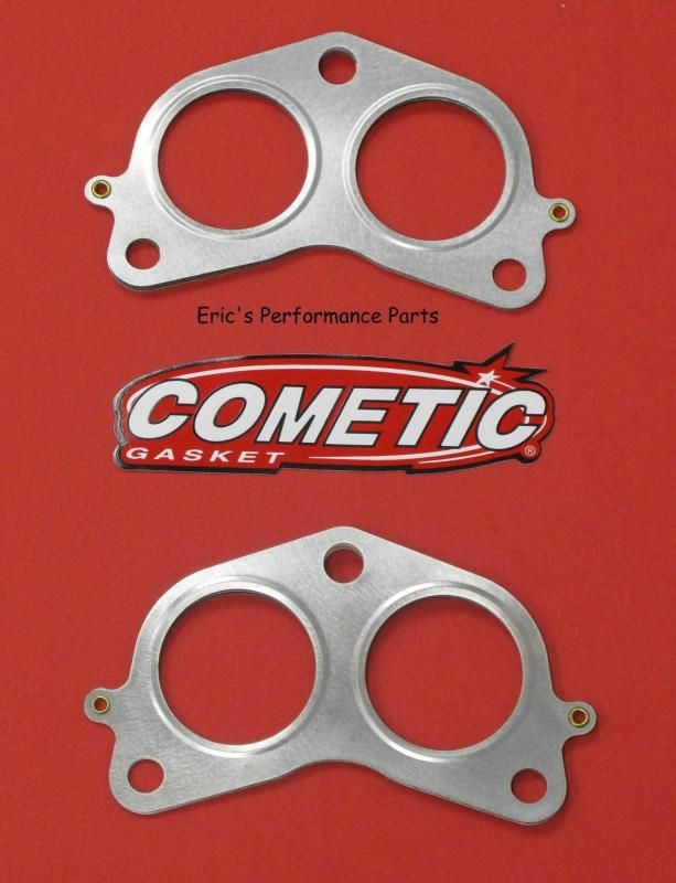

You can use the EJ20 Cometic Exhaust Gasket with some cutting or widening the holes a bit. They come in a pair.
Link: http://www.ebay.com/itm/Cometic-C42...ts-EJ20-EJ25-Subaru-WRX-STI-JDM-/150805157084
Part Number: C4204-030
Pics:
