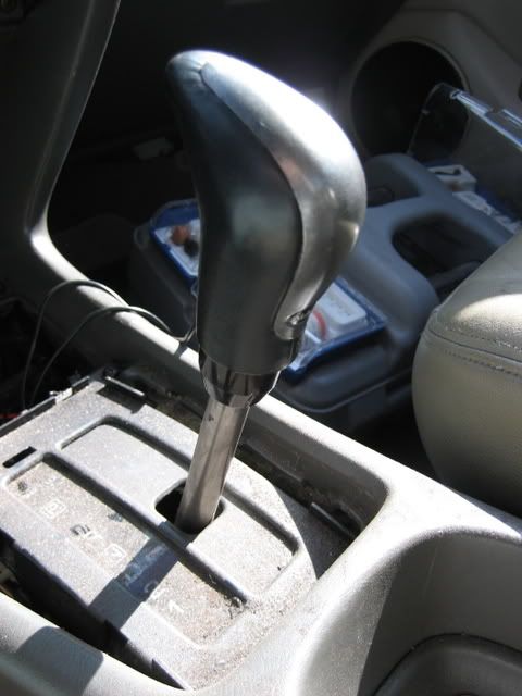

Once the shifter has been removed, you will need to cut the metal
shaft down to a size that suits you. I made mine nice and short
cause i hate how tall the stock shifter sits. Make sure you leave
between a 1/4 and 1/2 inch of the center post to engage the
mechanism and be able to shift gears.

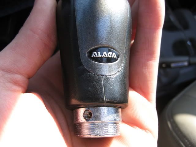

With your new MT Universal Shift Knob in hand...
Place it over the shifter. With it sitting exactly how you will want it to
once you are finished, take your fine tip Sharpie and place marks within
each of the screw holes extending from where the shifter will sit when it
is at rest, and when you press down on it. My knob has three holes...

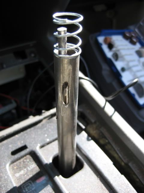

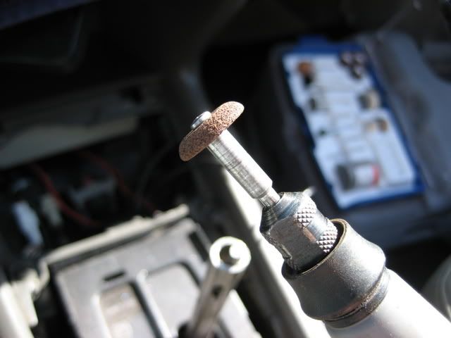

Step 5:
With your Dremel in hand and grinding wheel attached...
(this is what the grinding wheel looked like after i had finished the project)
Begin to grind out openings for each of the screw holes. it should look similar
to this once complete (be sure the openings are high enough to allow the
shifter to disengage once put into gear, and low enough to allow for full verticle
motion when pushing down on the knob).
Note: The spring pictured above is optional. it is not necessary to make this
project work, but it allows for a firmer feel when pushing down on the
new knob. i got this from the inside of a 1556 bulb socket and it fits
perfectly in side the knob, and sits nicely on the shifter tube.

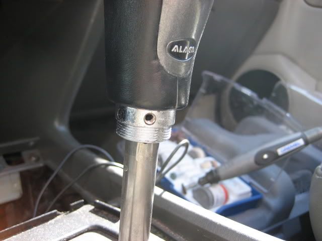

Step 6:
Once you have finished grinding out the openings, place the knob over the
tube, take the screws you acquired for the knob, and screw them in place.
If you did the cutting correctly, the screws should extend through the cut
outs and firmly hold the shift knob in place, while allowing for smooth
movement both up and down on the tube.
My shift knob has a piece that screws onto the bottom to hide the
screws. If yours has one, make sure it clears the screws you have
used to anchor the knob in place. If it doesnt clear the screws,
grind them down until the bezel will bit over top again (i had to
grind the screw heads down to fit he bezel over properly).
Make sure you test the knob in ALL gears ti ensure that
you wont have any issues once the project is complete.
If you are having problems with knob getting stuck, or
not properly engaging and disengaging gears, extend the
openings on the shifter tube at the tops and bottom.

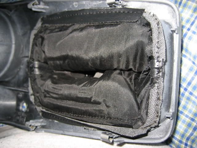

Step 7:
Now that you know the shifter knob works perfectly, remove
it and move onto the shifter surround. Take your exacto knife
and shift boot, and cut out the metal bar that snaps the boot
into place on the MT shifter surrounds. Then fold the edges
over the bottom of you AT surround (you may have to trim
a bit here and there), and epoxy them in place along the
bottom edge of the surround so you wont see any glue when
its in its final form.
Flip it over aand it should now look like this...

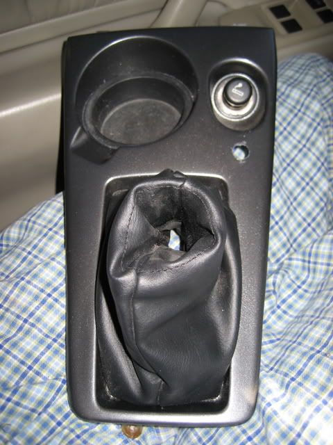

(i folded the very top part of the boot inwards b/c it accomodated my knob better)
Step 8:
Depending on what type of toggle switch you choose
to use, drill a hole in the shifter surround where you want
to place it (make sure it will clear everything once the
surround is snapped back into place before you drill)
Step 9:

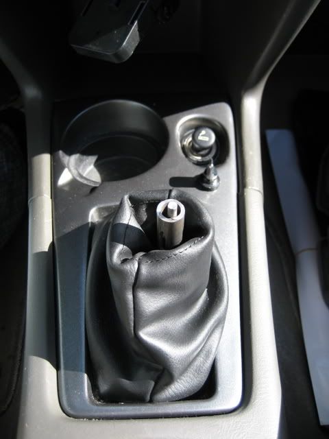

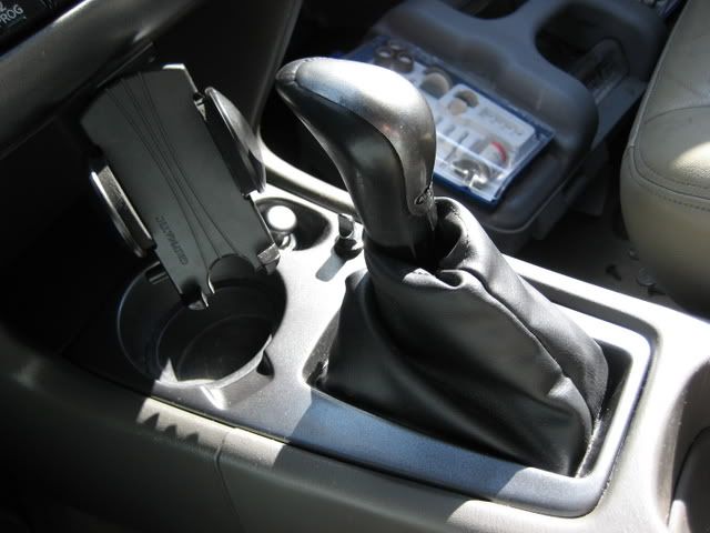

Put with shifter surround back into place, reattach the Cig lighter
socket, secure your toggle switch, and snap it into place...
Step 10:
Reattach the MT shift knob, step back and enjoy
Anyone who drives my car has a very hard time believing that
the shifter is a custom job. If done correctly, it will move up and
down extremely smoothly, and be held firmly in place.
