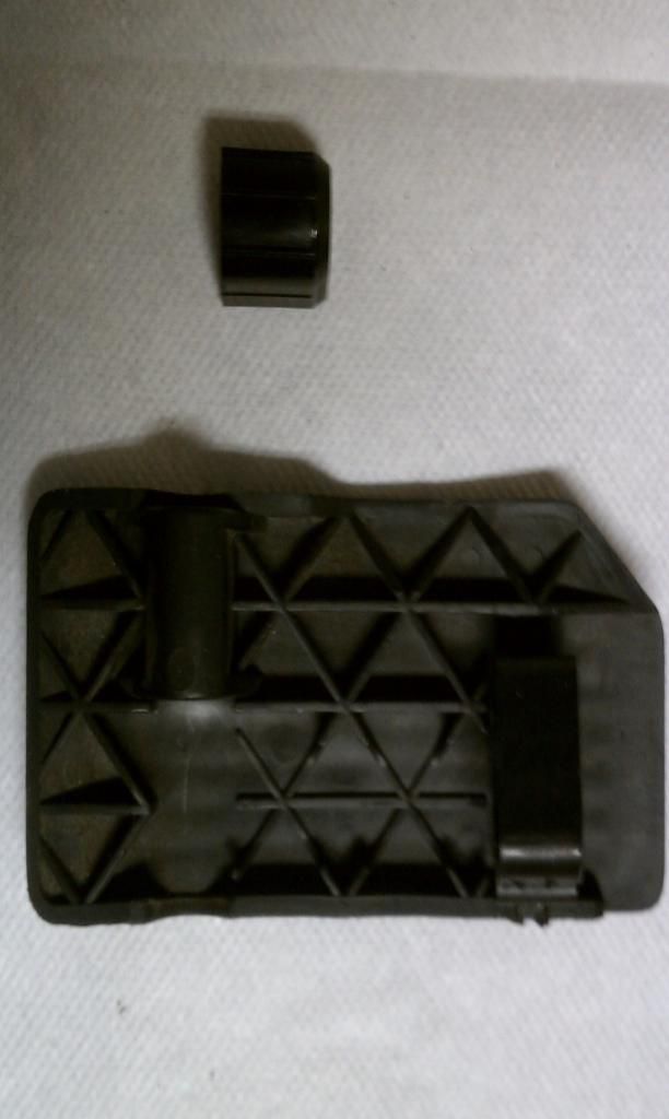

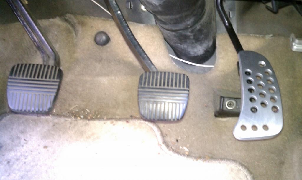

Everybody knows the stock pedals are too far apart to heel toe consistently. Well, I fixed that by installing the JDM 380RS gas pedal. It looks great by the way.
Tools needed:
1. Flat head screw driver
2. Drill
3. 3/8 drill bit
Parts:
1. 380RS Gas Pedal - # 18016-AB000
2. Clip - 18014-AB000
3. Bushing – 18014-8H601

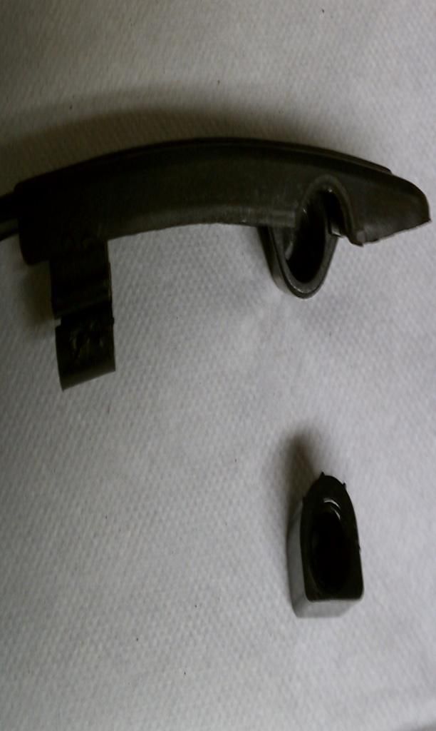

Removal:
-First remove the stock plastic gas pedal with the flat head screw driver
-swing the pedal downward and it should slide off the bushing
Install:
-drill the bushing with a 3/8 drill bit. Our gas pedal rod is a lot bigger than the 350Z.
-place the bushing in the pedal
-insert the pedal rod in the bushing and swing the pedal upward.
-finally fasten the clip.
Easy, now you can go and heel and toe like a champ.
Also a supplement to the install.
http://my350z.com/forum/body-interior-exterior-and-lighting-diy/555848-380rs-pedal-install.html
The stock clip and bushing is molded to the plastic gas pedal, that's why you have to buy the clip and bushing separately.

the 350Z clutch and brake covers fit the p10 pedals. they are not fun to install, but they look great!!
