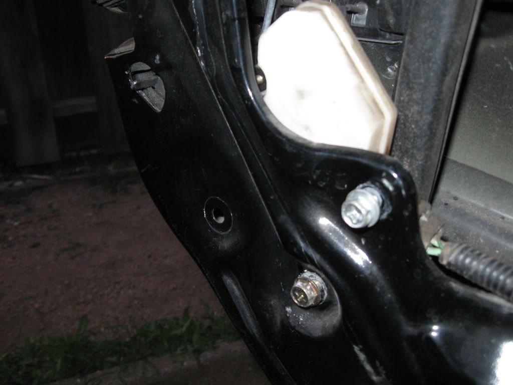

2) We'll start with the front door handles. First of all, there is 2 nuts holding the exterior door handle in place. One of them is easy to reach pictured here.

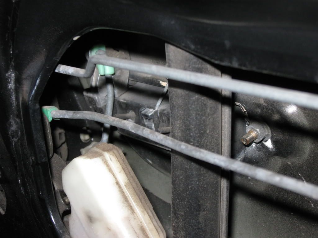

The other one is hidden behind the inner door panel, and the lower window guide. To unbolt the lower window guide you need to unscrew the 4 screws near the striker plate( I think thats what its called) pictured here.
There are also 2 or 3 10mm bolts you need to take out in order to adjust the door lock linkages out of the way.

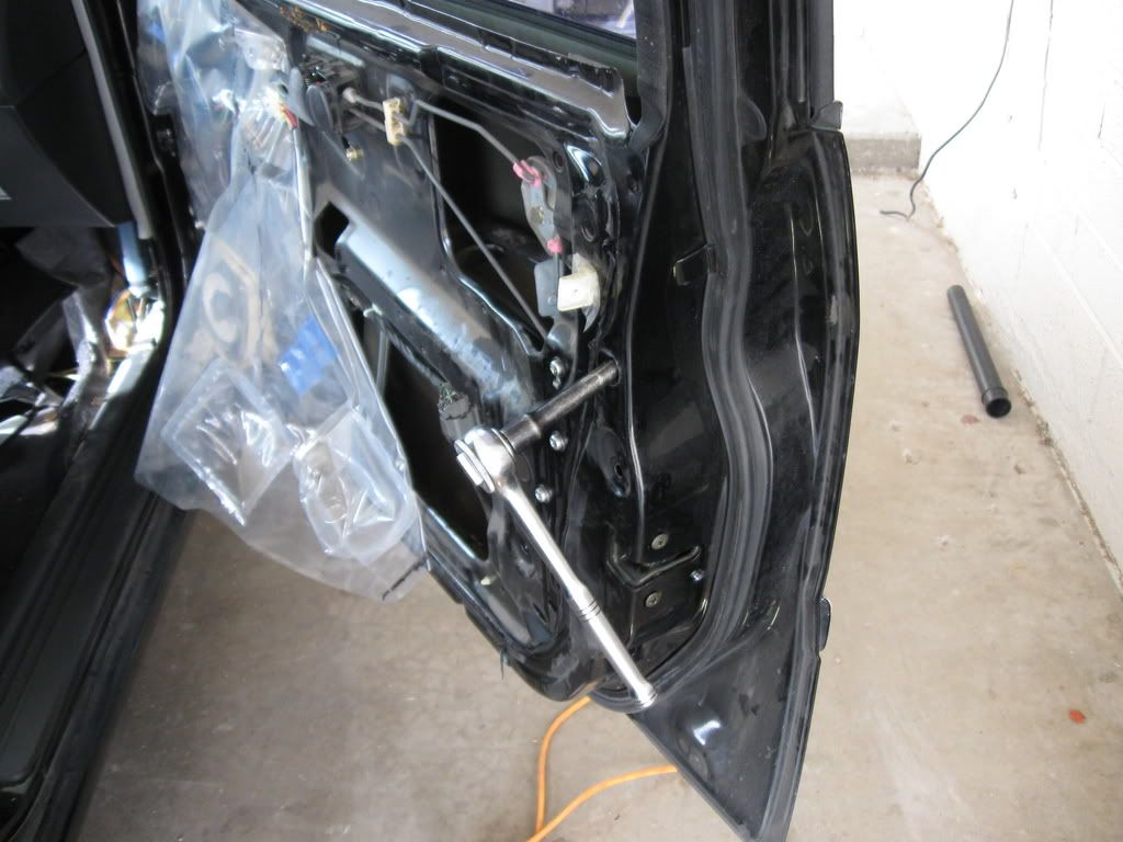

3) Ok, now it's time to attack that hidden nut holding the door handle in place. There is a black plastic plug that you need to pop off in order to get to it. Now reach inside the door, and move the inner window guide out of the way so you can access the nut. The plug is pictured here where the socket is placed.

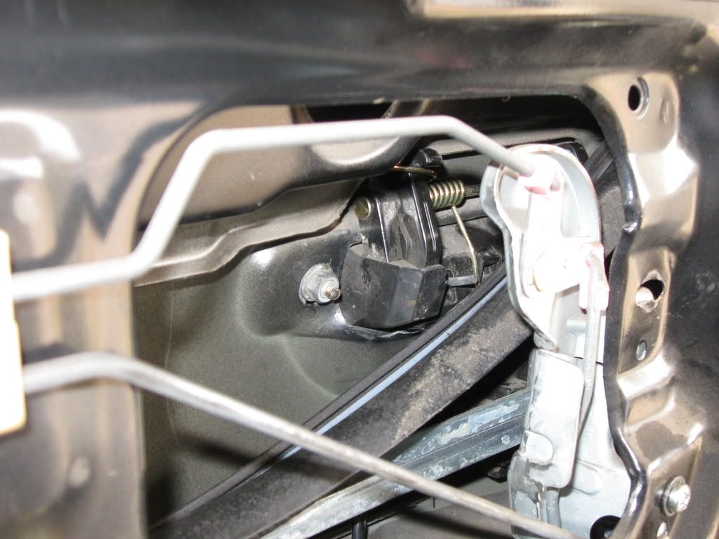

After you get both nuts off the door handle its held on by one wire linkage guide. You'll need to wiggle it a bit, and maybe use a flathead screwdriver to disconnect it. The handle should be out now, so just swap in the new door handle line everything up, and assemble the same way you took it apart. Front door handles should be done now.

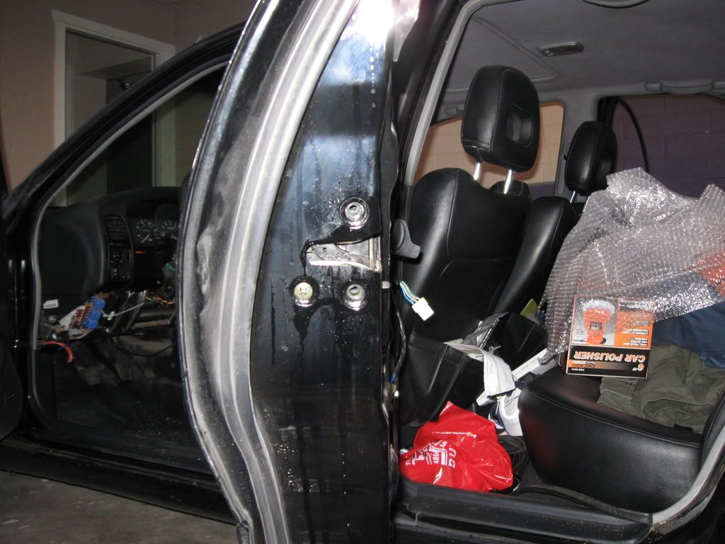

4) Now its time to do the rear door handles. After the door panels are off, take off the 10mm nut holding the door handle on pictured here.

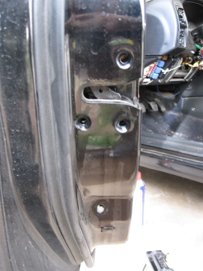

Then, take out these 3 screws holding in the striker plate. Here:
Also, remove one or both of these bolts here to allow the striker plate to be adjusted.

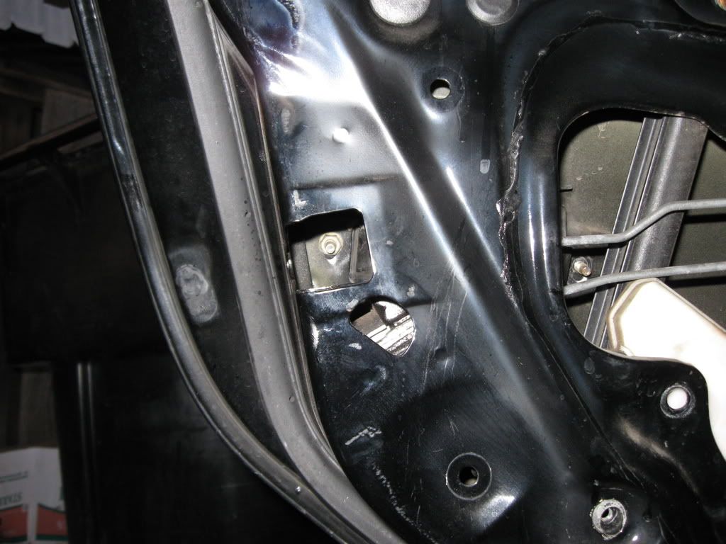

Now to reach the last 10mm nut use an extension to get it out where the striker plate was located. Pictured here:
Now unclip the wire linkage guide holding on to it, swap door handles, line it up, and re-assemble in reverse order. Now go wash your hands, and tell everyone on g20.net that you finished changing out your door handles. If you have any questions lmk.
