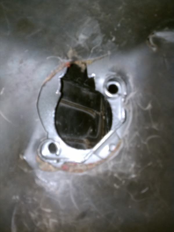

now you should see the hole where the clutch cable came in. you are going to have to open that up to fit the master through.

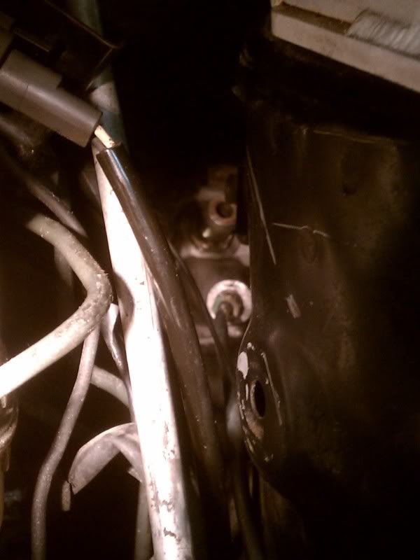

i made a template of the master. (i also used this template to form the gasket ) then transfer ed it to the firewall.
now you need to cut the firewall. a air saw / body saw works well...or snips if desperate. (not recommended since the cuts are ugly. also the standoff was still on the firewall in this pic)

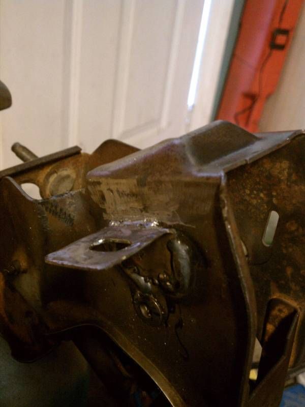

bolt loosely so you can mark where you need to weld a tab on the clutch pedal for the 3rd bolt
bend a piece of metal. mark for center of bolt hole. drill . tack tab to pedal. test fit. tweak. final weld

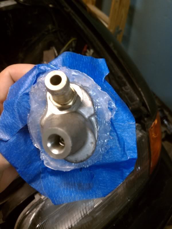

now that all 3 bolts can be used. i then took the template from earlier and made a gasket with some painters tape and silicone. this will prevent water from getting in the hole you made for the master (the tape is just so the silicone didnt stick to my template..its not part of the gasket)

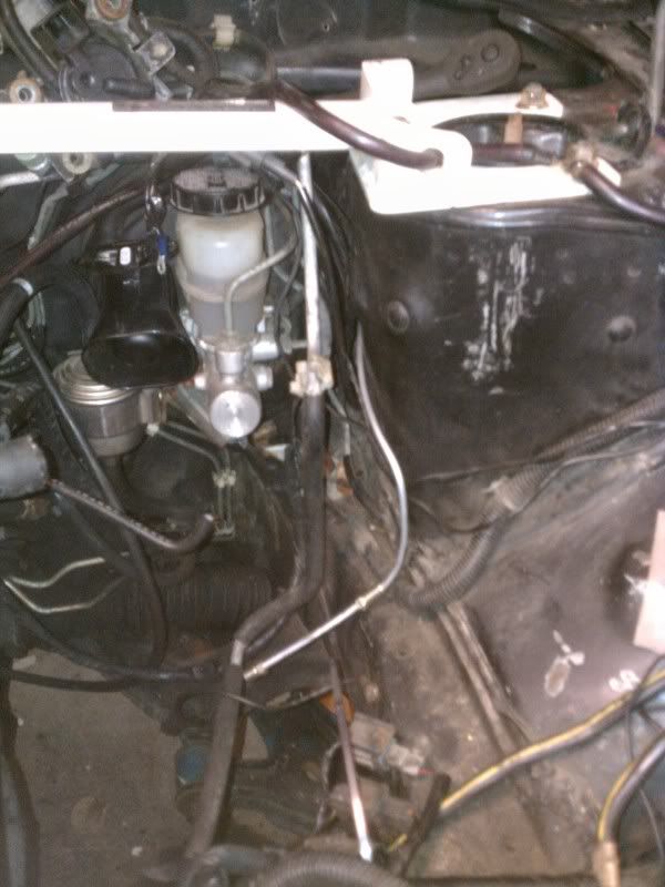

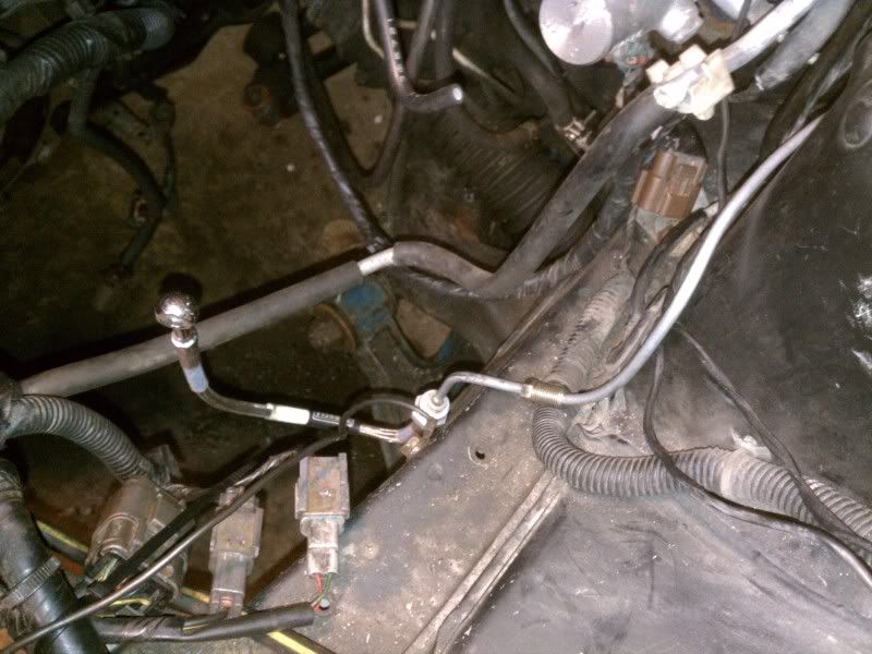

as i mentioned i will not be using the damper or rubber lines. i will be going directly from the master to a hardline i bent, then from there to the stainless line into the slave.
using the damper/oem setup you will go master/ damper/slave

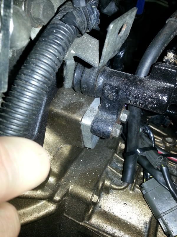

mount your slave to your tranny with the spacer in between
now mount your resivor up by the strut tower...i used the stock mounting point for the

I have a tab weleded on the side of the p11 pedal so that i can bolt it to the top mount, i can bolt 1 of the stock bolts into the firewall,,,but i cannot get the other one. for 2 reasons.
1) when using the cable system, there is a little brass cup that the cable slides through...this has a stud pressed into it & goes in the upper right hole behind the strut tower (this is the one i cant figure out how to duplicate)
2) being that i am not using the cable system, i have to connect the 3rd bolt, but dont know how. I was going to tack it to the pedal, & then when sliding it through the wall...i realized there was no way to get a wrench back there to tighten the bolt.

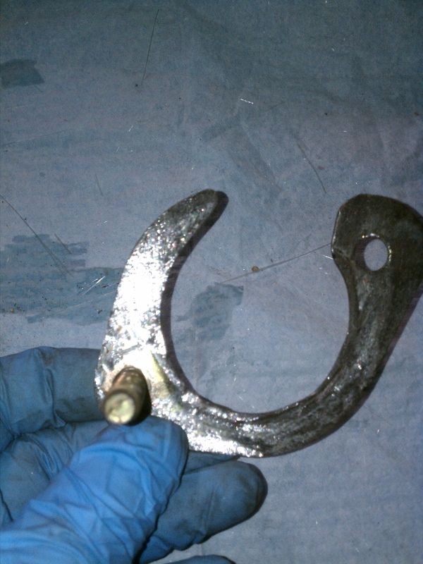

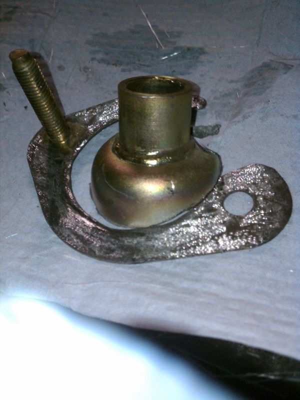

ok i managed to over come the issue with the bottom bolt that is impossible to reach from the engine bay
take the stock cable sleeve & cut
then clean it up a bit (i had a template of the MC that i used to make sure it would clear)
& now its ready

hydro setup all mated....& trans is 100% ready to go in now
