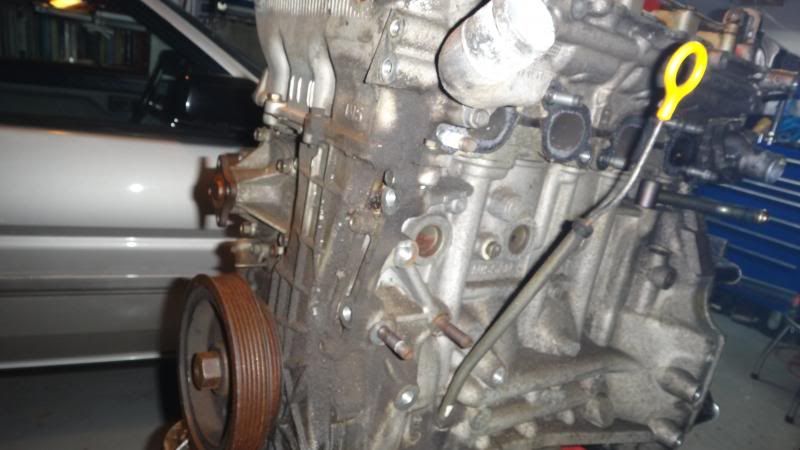

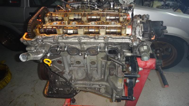

deciding if i should get a new front cover or just reseal this one .
couldnt wait to take apart everything even though its 10*F outside. (no heater in garage)

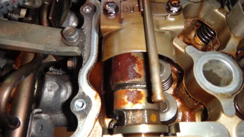

some lobes had this nasty oxidation/carbon build up , it scratched off though

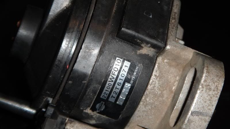

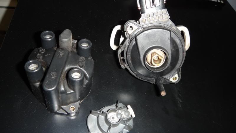

i started stripping the motor and noticed the distributor was not sitting flush with the head . Did i get screwed here , im almost 100% that this is a roller rocker dizzy(triangle style rotor shaft ) .
The VE is suppose to have a 1N5 number and one ear only correct ? I was set on using the VE dist and rewiring my current harness.
http://www.g20.net/forum/showthread...se-VE-Distributor-with-USDM-Rotorhead-and-Cap
Hopefully the photos in there will help you. FYI RR and VE distributors appear to have triangle rotor shaft
thats what i used as comparison , the ve rotor shaft is round and has a screw to hold the rotor , the tabs(ears) dont allow this current dizzy to mount up . fml
Dont use the ve dizzy, just cut the bottom tab off your p11 dizzy and your done
Incorrect!!!!! P11 dizzy is no good for ve......it will fit if u cut the bottom ear off....but you wont be able to adjust the timming.Either rewire the ve dizzy or get a B15 dizzy.
use my stock dizzy and cut the tab off , wouldnt it be easier to just rewire a ve that fits in without having to cut ?
:angry:
Trey, no disrespect but I think your stuck in the jim wolf ecu days. Freddy belive me, , use your stock dizzy. Yall like to make this more difficult than it really is.
