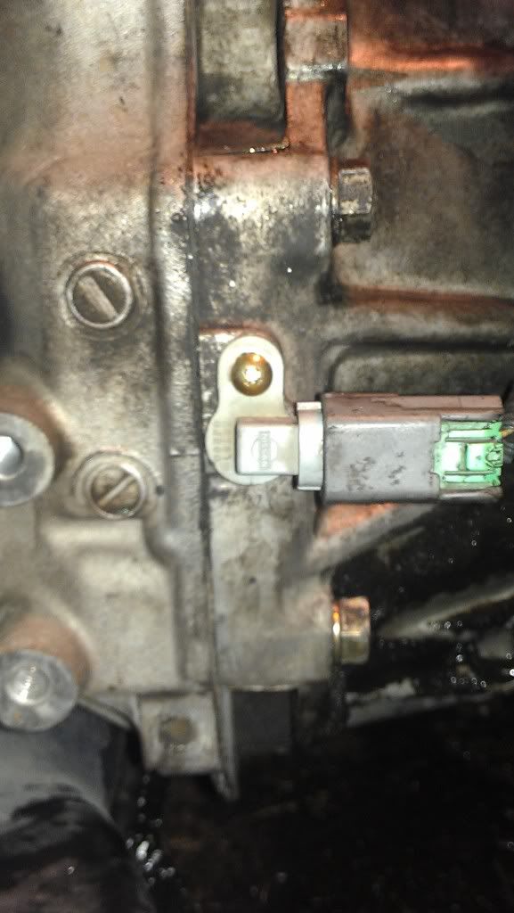

yeah its the 108 teeth.. on the pic from post #4 you can the the white marks i did to count the teeth.. i always had the code.. at the beginning i didnt have a hole on the tranny for the sensor..
[/URL][/IMG]
so i made my own.. but my lazy a$$ didnt took the tranny off to make the hole. so its wasnt straight were it was suppost to be..
its slightly to the side,tilted down a bit and its not pointing straight to the flywheel..i switch few cp sensors but the code never came off..
how can i adjust the starter?
when you mount the starter, theres a little play.. try to push starter up (giving starter gear to flywheel gear some distance) next time before you secure the bolts. as for the crank sensor, that thing needs to be w/n nissan spec in order for it to work properly

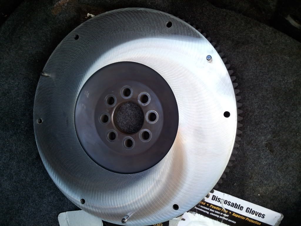

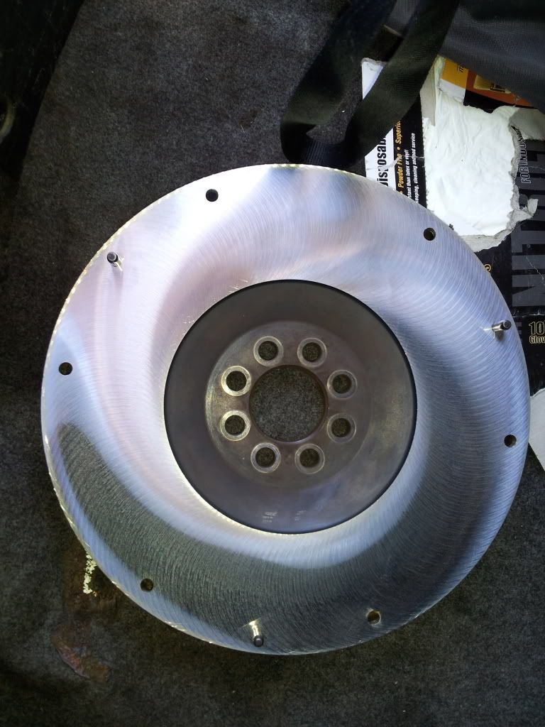

just got the flywheel from machine shop..
does it suppose to be flat or with a step?? does it look right?

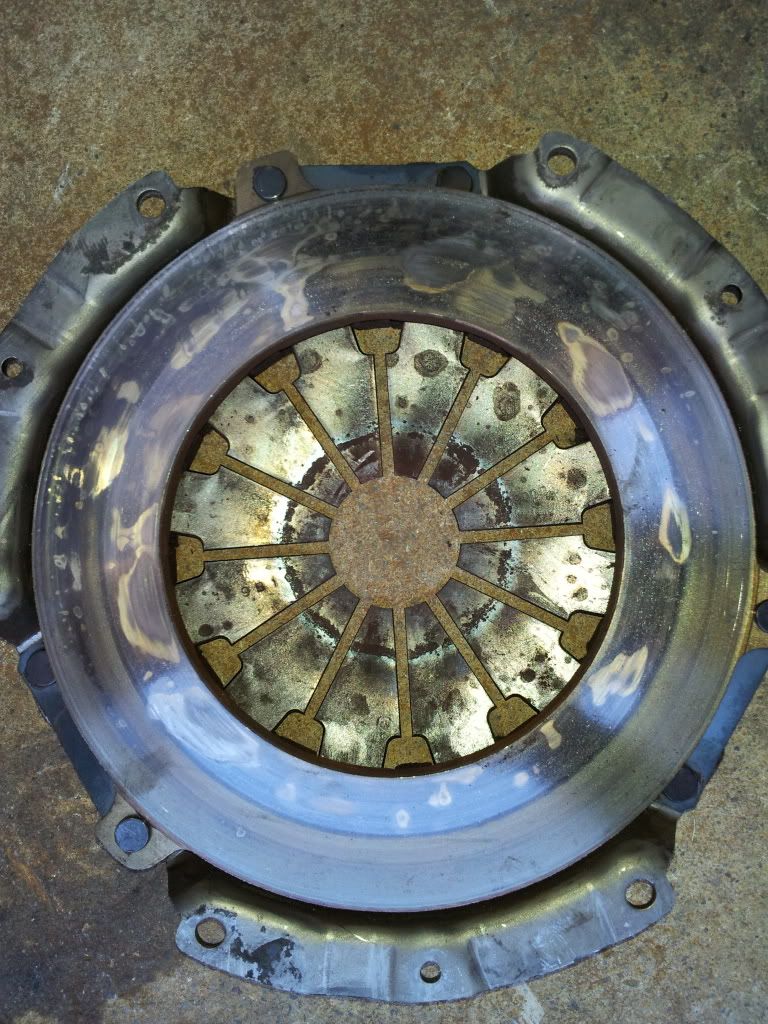

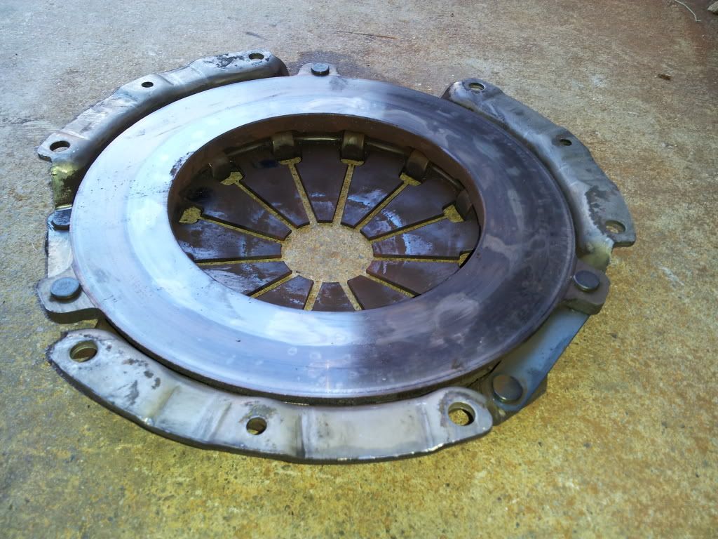

am in a really tight budget on this car so i try to spend as little as possible.. i found a clutch disk and pressure plate in really good conditions for $5 bucks at the junk yard.. witch am going to use for now.. but i notice that the pressure plate from the exedy clutch that i took off my car its perfectly flat and straight..
in this pic you can see the bottom of the pressure plate, did no make contact with the disc cause those 2 bottom screws holding the pressure plate to the flywheel where snap..
has no lip or nothing.. its nice and smooth.. can i clean it up a bit with sand paper and reuse it?? what would be the bad on using it??
You were asking for trouble running a clutch with missing bolts. Not to mention they were beside each other.

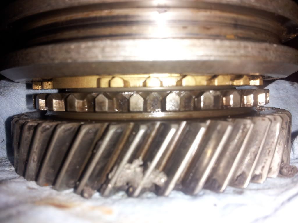

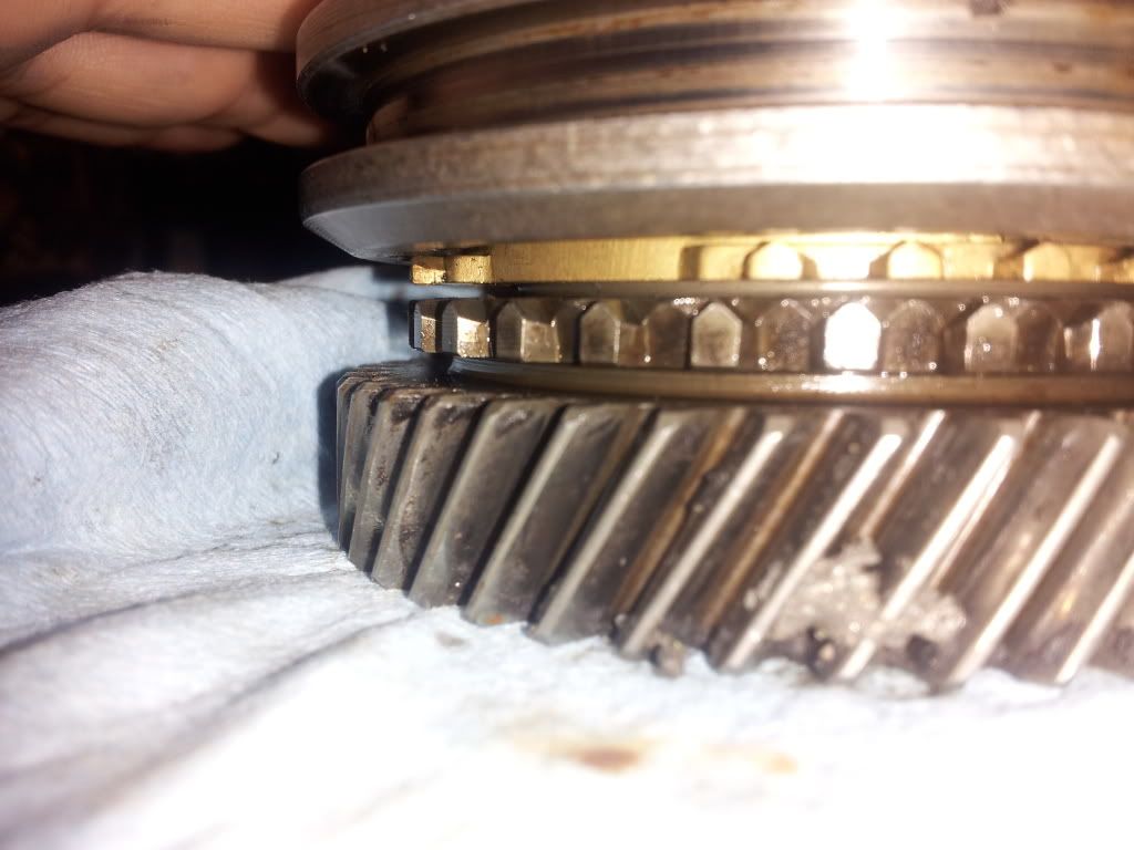

i found this 5th gear at the junk yard few months ago for $5 bucks, to replace my old one that was popping out..
seems to be the "newer" redesigned gear that has about 2mm between the gear teeth and the dog teeth...
but it came off a 95-96 cant remember exactly.. any experience on swapping gears from one year to another??
some one said that if it was a 99 tranny then yeah it will work, but not sure if my tranny was a 99 do to the fact that it didn't have an crank sensor on it..
don't really wanna put it in and destroy the whole tranny cause of the gear.. but i been searching for few days now but cant find any info..
if your tranny did not have a hole for the CPS, your tranny is a old 94> p10 tranny, or some B series Tranny
ok koo thanx!! so ill be ok with the gear that i got...any reason to do that?? shorter gear ratios? or something? also my driver side axle was not all the way in the tranny?
