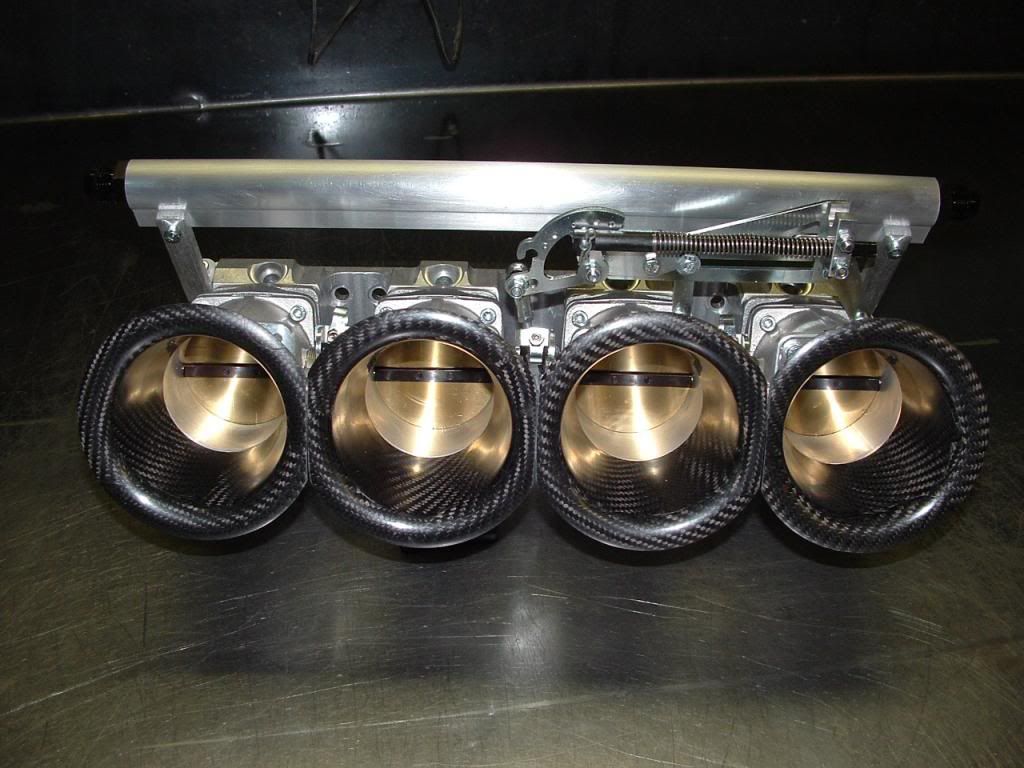

Hi everyone would be awesome if someone can tell me the year make and model of the Suzuki Hayabusa Throttlebody i can use for my 1996 Infiniti G20t. And also would like to know the dimensions. I have seen a build with a busa TB for the ITB but have failed to find what gen the TB.

Pretty much any year 99-08 I believe is first gen and cheapest. And if the ITBs are not done/built right they make less power a lot of the time. The older throttles are cheap though
those are pretty
to the OP...... what ecu are you planning to use for this setup?
Why not start with a GTiR setup. Might be less fabrication.
