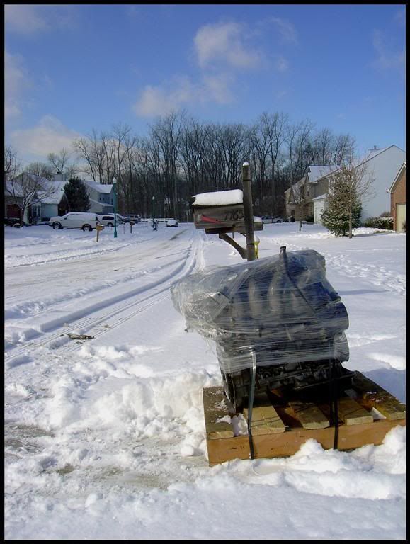

this is as far as the delivery guy could get it because his pallet jack wouldn't go through the 6 inches of snow we just got.

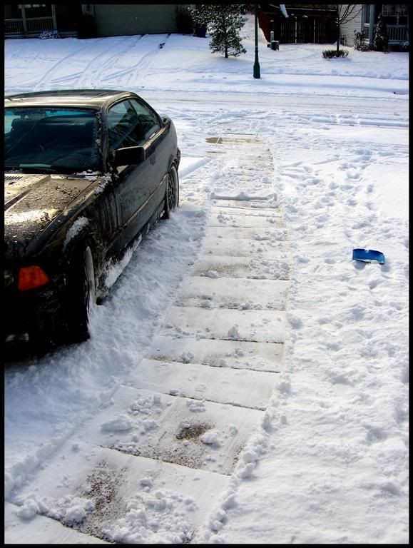

the trail i made when i had to drag the stupid thing by myself into the garage (i need to start working out). That's my roomate's 328is i borrowed to get to the garage i'm working in, it's fun in the snow.

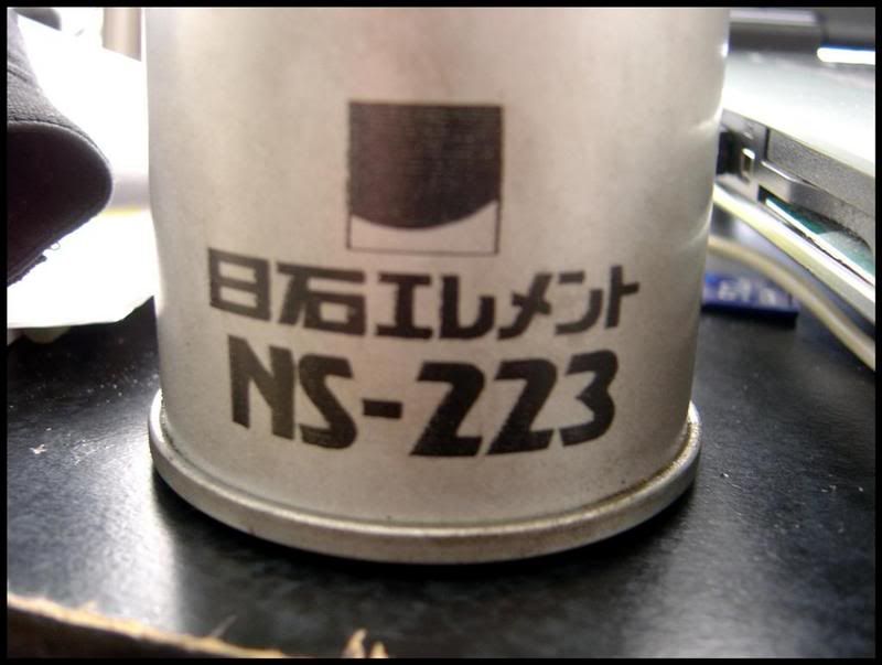

mmm jdm oil filter haha

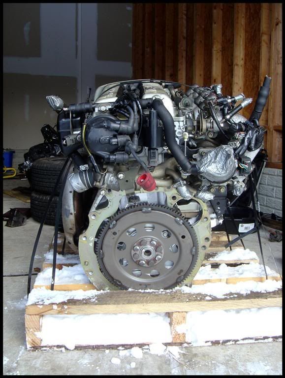

and one of the motor unwrapped for now.

oh yeah, does anyone know where this tube goes from the throttle body on a highport motor, this pic is looking at it from the rear of the motor. (the tube with the white lettering/numbering on it)
i found the same one on my lowport but checked the FSM and thought it was part of the egr ... but it's on the new motor which doesn't that so i'm slightly confused haha.
CH0DEmobile
3,202 Posts
hrm, I just replaced all my vacuum lines, seems like I'd remember what it did. Would some pics of a lowport help? I can snap some of mine tomorrow if you need them.
EDIT: I thiiiiiiiink it goes into the intake right before the throttle body, but I could be wrong.
