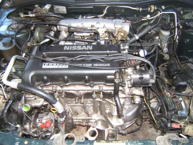

So what am i doing this time eh ;)? Projekt: VE-T of course! I will not be boosting a VE block because im not too secure about the weak bottom end, high compression, and the 4cw crank. So i will be using a avenir block with a VE head. SO yups, another frankenstein motor! It also doesn't help that i scored a avenir W10 motor with everything attached for only $900!! :naughty: So the results of this motor? Stronger bottom end, 8 cw crank, oil cooler, and oil squirters. I will be running a W10 T25 for now untill i can get my funds rdy for something a little bigger ;)

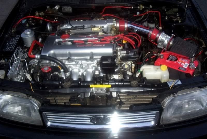

V1.0 - Auto P10

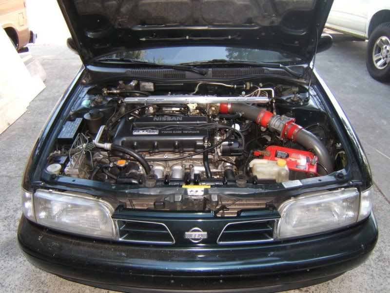

V2.0 - 5-Sped VE 194.5hp/144tq

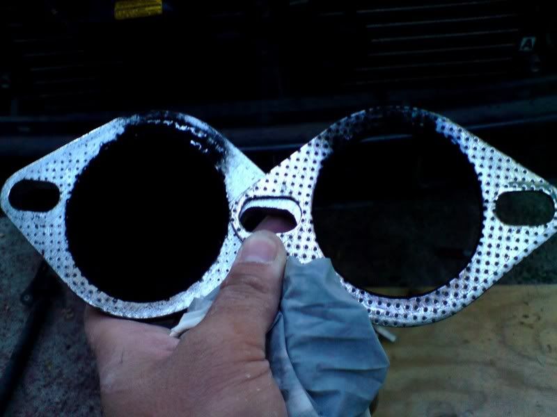

What sucks is that i dynoed 194hp, but found a exhaust leak on my DP.... Im sure that was worth something... :confused:

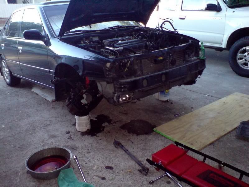

V3.0 - VE-T ;)
Day 1
VET SETUP:
VE-T Hybrid. W10 bottom end + VE head
w10 turbo + stock wastegate @ 9psi
Custom IC piping. 2'' hot side, 2.25'' cold
Z32 MAF
JWT ECU
370 injectors @ 4 bar
2.5'' VRS downpipe
2.5'' VRS cat back + Magnaflow resonator/muffler
stock sr20ve cams @ 5000k activation untill dyno tuned
9 lbs Fidanza flywheel
SPEC PP
6-puck Clutchnet clutch (spung)
4 pc UR pulleys
2.5'' resonated testpipe
Walbro 190 fuel pump
