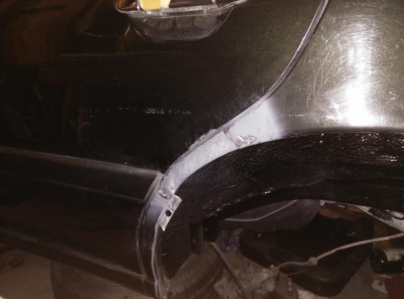

so got more work done...
some rust...poked at it...then primed until next time
cut out all the rust...the back panel was also rusted....cut it out
then got a part of a qtr from a junk yard & cut my piece i needed out to fit...
then welded the inner in, added some "NU-metal" filler to make it smooth/prevent rust from comming back, then etched primered the inner panel from the hole as well as from the trunk...(dont have a pic)
then weleded in the outter panel..this actually was pretty damn good after weleding & grinding,, i almost didnt want to add any filler, but i had like 2 burn thrughs that required me to dump mpre weld into it, & slighty warped it a TINY bit...but then i had to hammer the weleded area down lower than the panel so the filler was flush with the paint...smoothed it all out, then through some primer on it to check that it all looked good....
i still need to put a guide coat on & do another sand...then put on some very lightweight filler to remove my sanding scratches...but then its ready for paint!!!!!
I do still have to do this dog leg as well....but the inner is now done (needs a bit more sanding/grinding)....just need to do the outter...both the inner & outter were rusted through a litte bit just like the one above..

yes....luckily ALL the rust is now gone...it wasnt much .
just those 2 spots, then on the pass rear wheel well at the bottom, then on the oppisite side of the wheel well on the rocker end...but then also on the drivers rear wheel well on the rocker end...
now i need to fix the 1088901809810707 tiny dings i created over the last 3 years hacving this thing on jackstands in my 1 car garage...(always bumping into it, scratching it with shit)
