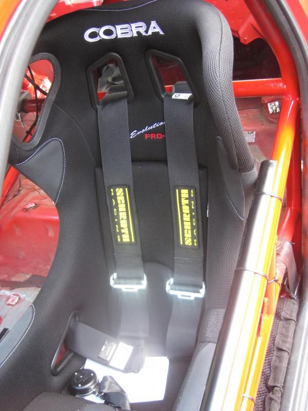

Charles is 100% correct, its all how much you are willing to deal with while still driving it around on the street. I agree with what Chris and Charles said, start with brakes and pads, then hit the track, you'd be surprised how well the car turns and moves stock, get used to how the car feels, how neutral it can be under braking, etc. Then slowly fine tune the car to your liking, suspension, engine mods, etc.
My car is 100% streetable as well as 100% trackable, all I do is bolt in my harness bar, swap brake pads and I'm on my way (if your running SCCA or NASA, you also need a real track seat FYI, and Schroth belts don't pass NASA tech any more due to rule changes ;)).

^ Schroth also makes FIA 3" 5 and 6 point belts that still pass both NASA and SCCA tech keep in mind ;) ....and we have FIA 5 year rated SCHROTH Pull-Up belts in our B14 now btw:
I'm referring to the 4 point "cheap" belts that they used to allow that bolted up to the rear seat, those are still floating everywhere.
..........4 pt anything shouldn't be allowed in any track (or street car for that matter) anyways as the lack of submarine prevention is quite dangerous.
