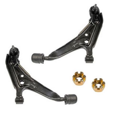

so like a lot of guys i'm running the generic p10 lca's i got on ebay
but when i jacked one of the balljoints, i ordered a new p10 balljoint only to find it WONT FIT!??
any idea what balljoint these aftermarket lca's use?

what ur gonna have to do is get that huge book from napa, measure all ur specs and find u one that matchs... or get ur oem ones back and buy new oem ball joints.
yea i don't think they were designed to be changed. total bitch to get them out

I bought an ebay china LCA the balljoint only lasted 4 months before it got some play in it. I tried alot of replacements none of them fit. They are complete crap. Eventually ordered a oem junkyard lca for 40 bucks off ebay.

The Stock ones measure 1.50
China ones are 1.51
