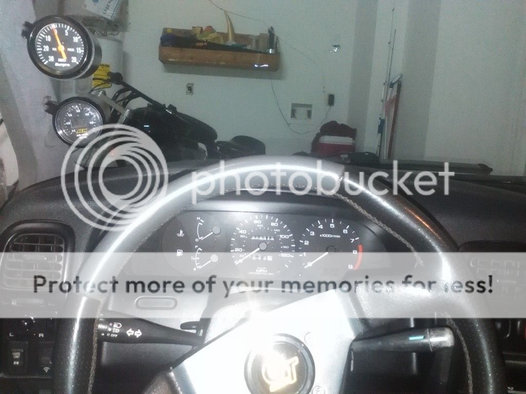

Swapping gauge faces from +93 ugly "fancy" numbers to -93 blocky numbers.
the speedo face was slightly different, and required me to redrill the trip reset button hole, and trim the tripometer window. I just directly swapped the tac assymbly over since the +93 tac seems to be less responsive or slow. Minor detail. Just something fun to do on a Saturday. I thought I had LEDs here, but I guess I brought them to work, so will probably run over there tomorrow just to through in the bulbs and button it up

Pictures on this post. Replaced front wheel bearings with timken and sway bar links with moog last Wednesday. Next will be lca bushings (going energy suspension) and ball joints.
I also made a slight adjustment to my ignition timing and fixed a couple of small boost leaks. The car is running and driving great.
Did a custom a pillar pod set up.
aem wideband failed on me. After replacing the sensor and testing the whole system off the car, the actual head unit/display is bad, so I will end up replacing that soon hopefully.
