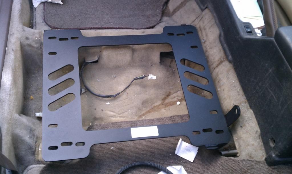

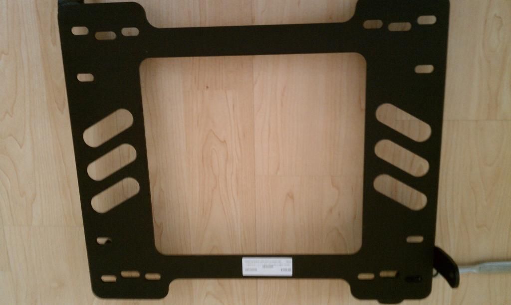

Construction: 3/16 thick steel plate.
Appearance: Flat Black
Origin: Made in America
Price: $140
Part # Driver Side: SB193DR

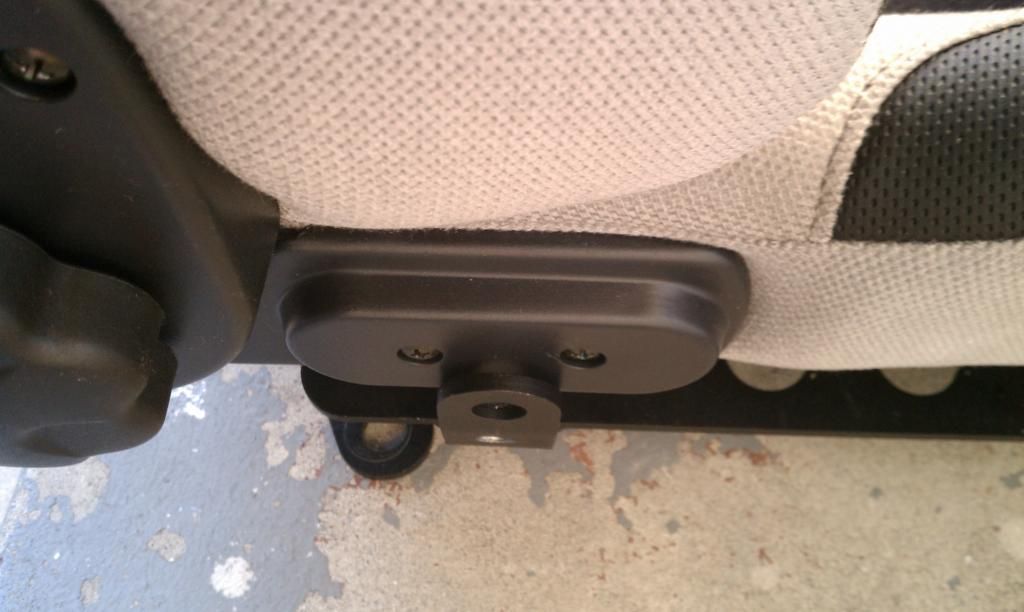

Pro’s: High quality appearance and construction, fair price range, sturdy, versatile(can accommodate a lot different seats). Major plus is made for the P10, which is rare.

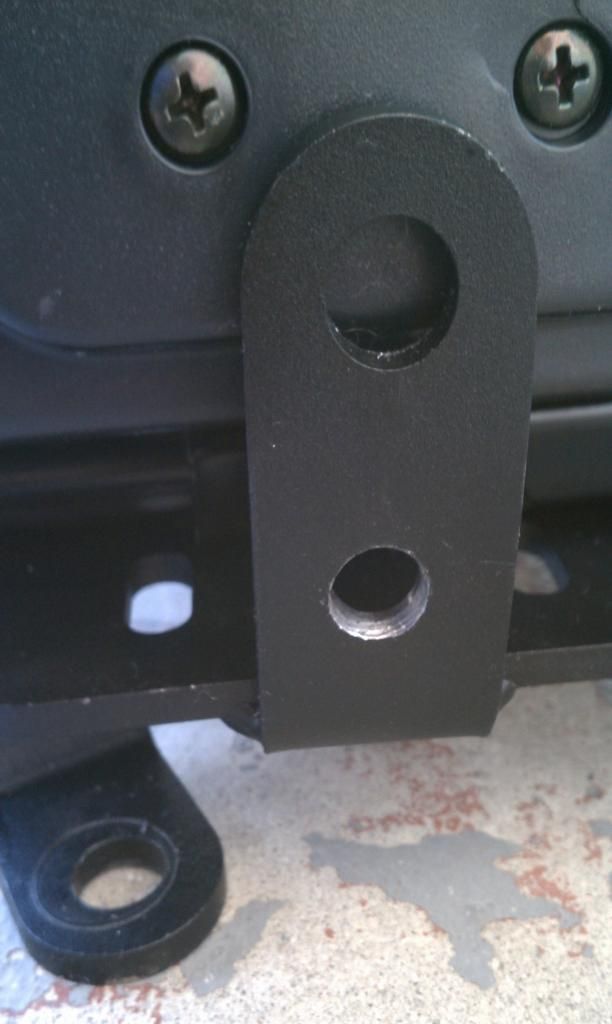

Con’s: The seat belt bracket is too close to the seat. I had to drill another hole to allow a bolt and nut. I suggest in the future Planted should either thread the bracket hole or remove the bracket entirely so to use the seat side mount holes.
Problem: seat belt bracket is too close to the seat to allow a bolt and nut
Solution: drilled another hole

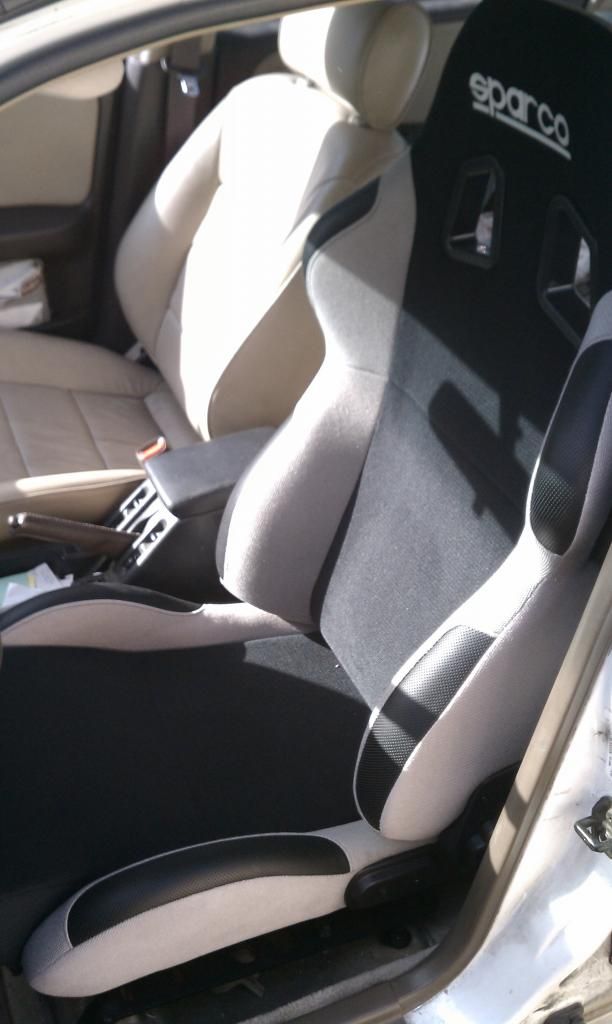

Well you are in luck. Seat height was also a concern for me. With my Sparco seat and rail, the seat is 1.5" lower. It's a lower seat position, so much so that I can't adjust the steering column any lower.

Seat looks great in the car!
are you running sliders? or is it fixed/ (looks like your running sliders..)
would you say its higher or lower than the T power seats?
higher or lower then the manual non Elec seats (i believe the T/elec seats sit higher then the manual sliders)
