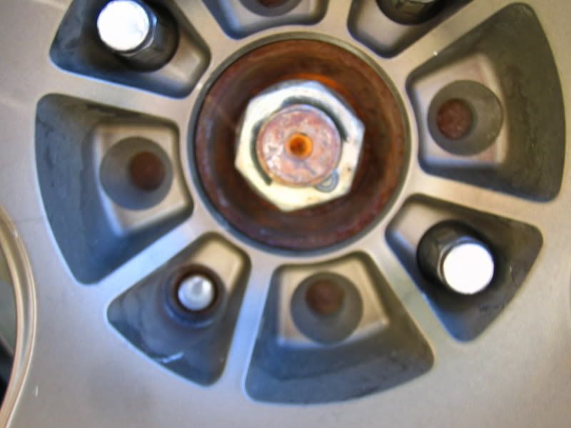

When I was tightening my lugs yesterday after doing my brakes I guess I must have twisted my lug on crooked (it went on easy, so I didn't think it was stripping) I tried to take it off today and it didn't come off..I had to snap the bolt off!! Anybody have a write up on how to replace one? I'm going to try to do it tomorrow, but definately Friday if not tomorrow.

Thanks for the picture! But I still didn't see the 19mm bolt I need to remove lol..I think I know which one I need to take off. They are the only other 2 by the caliper that look significantly bigger than the smaller ones that you need to remove the caliper. Still waiting on more info. to see if removing the rotor is the only way to do this. I want to do this early morning on Friday because I have to be somewhere at 8:40 a.m.
