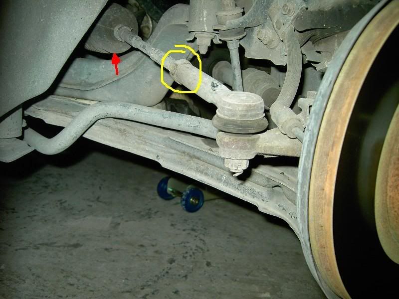

how can i get the boot circled in red out..i tried to get the damn tie rod end out with no damn luck its like caked in there.. in the fsm theres a way to get the whole thing out tie rod end along with thin part..just wanted to know if any one had any experience..

yea i tried whats on pic 1..but like i said its like caked in there..and theres on room for me to use a braker bar..i dun have a lift..
[/IMG]
but is there way to separate it from here marked in red..

Have you taken the inner end of the boot off the rack and had a look at the inner tie rod end ?? I'm not sure on how it comes off, it will probably have a locking mechanism like a piece of metal hammered into a recess to stop it undoing.
I'd do the outer tie rod though. Refit it and then break that nut free with some large stilsons.

No, that is not the proper way and is more work and has a higher potential that you will damage something.
Soak the tie rod nut overnight with penetrating oil. Then heat the nut up with a propane torch, and then remove it. It should loosen. Striking your wrench with a big hammer will often break the nut free.
Before doing this, you need to measure the distance from the center of the tie rod spindle to the end of the nut you are trying to remove. Record that distance.
Once you loosen the nut you will have to unscrew the tie rod from the threaded rod. Count the number of turns it takes to remove it. Remove the nut also. Another way is to paint the nut and threaded rod area before you remove anything. Then when you reassemble you put it back using the painted area as a guide. I usually do all three.
After you put your new boot on, thread the nut on and then thread the tie rod on, counting the number of turns until you get to the number it took to take it off. Tighten the nut up against the tie rod. Measure the distance from the tie rod spindle to the nut. It should be the same as the measurement you previously took.

I would have left it in the hub for a start while trying to break it free instead of trying while it's flopping around. I'd wedge one wrench/spanner/stilsons against the LCA or sway bar then you con put lots of pressure on the other wrench/spanner/stilsons.
